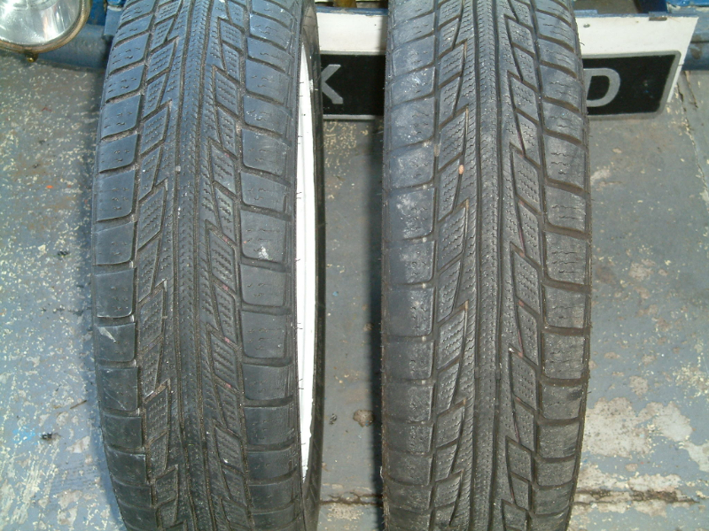

This subject is becoming TIRING ... so here is my say on the discussion .

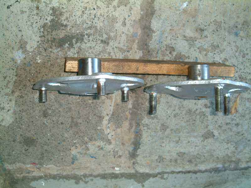

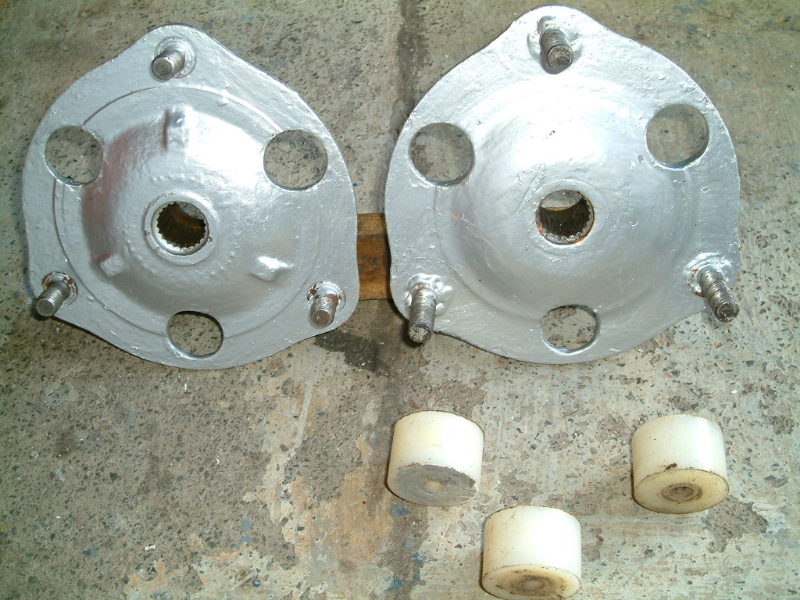

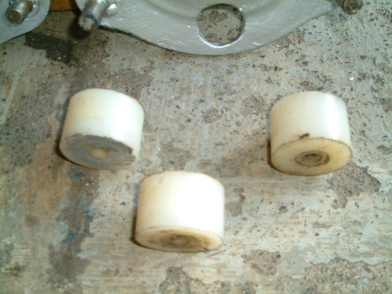

First is my comment on the front wheel probable faults, the distance between the inside edge is only 5 m.m. clearance between the King Pins bottom Cap, over a period of time the rim construction pressing starts to break minimally open , and a Knocking noise becomes imminent, as the edges rub together. I have had this happen on several Citroen 2 CV vehicles, over a 55 years period .
To combat this, I fitted longer Wheel Studs, and to compensate the Thumping of the Rim, I made Spacers out of Nylon Round Pole 45 m.m. diameter and a thickness of 30 m.m.
With the Wheels back on the front , there is now a full 1 inch clearance under the steering king pin assembly, as the inside of the Rim changes its shape in construction.

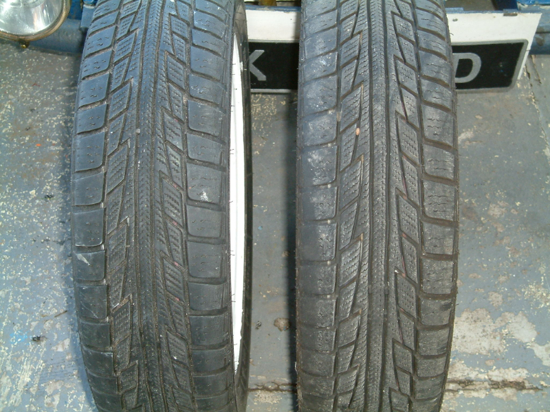

Now to the Tyre's business... I run my rear wheels ,Bridge stone on 195 x 70 / 15 cost £ 50 pair.
My Front Tyre's are Nankang 155 x 60 R x 74 T, cost £ 62 pair.
My turning circular is greatly improved , and the exhaust doesn't catch on full lock steering . My vehicle will still GALLOP at 65 MPH happily with its 602 c.c. engine, married to a 400 gearbox .
What more could I ask for.... ?????
