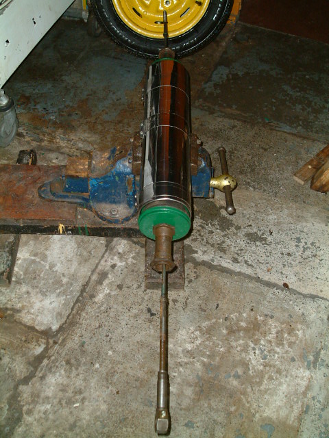

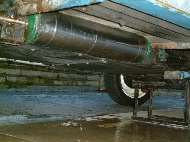

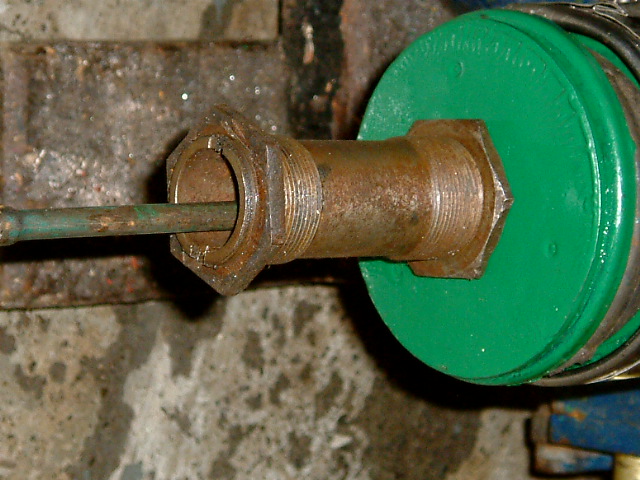

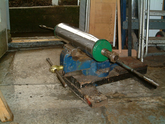

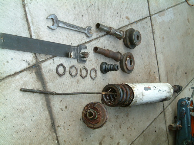

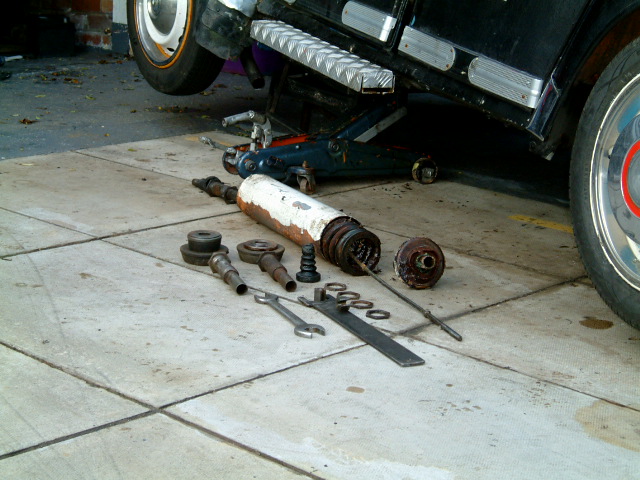

My question is.... what do you use to pull the suspension rods out in situ under the vehicle, when its jacked up, even after unscrewing the tie rods from the axle, it difficult to locate and re-start the Tie rod, back on a few turns.
If you can draw out the tie rod and hold it protruding a few inches that would do the job fine, I fabricated a fold over Jaw bracket, that slides along, then I tighten to holding bolts to stop it sliding back in to the cylinder.. but the Springs Strength over comes this. I Even substitute Vice Grips two pairs but to butted but it still slips,
I opened a pair of cylinders when I built my own Van Body, in the 1970s and cut a secondary pair of coils and fitted them in the cylinders before re welding them.. that certainly improved my suspension.with four coils in stead of two.
But as my Brain power is gradually slipping away, I cant remember how I pulled and held them , to hook them up under the axle.

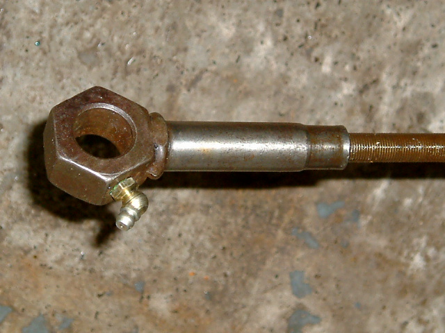

Another little modification I did was to fit Grease nipples in the Tie Rod Eye Holes.

Bien vu le coup des graisseur sur les sucettes

Si j'ai bien compris votre problème, vous essayez de visser et dévisser le tirant ( ou la tige ) de suspension. Normalement, au bout de cette tige il y a un petit espace plat ou il est possible d'insérer une clé plate de 9 millimètres. Après il faut tourner dans un sens ou dans l'autre pour régler la suspension, ou pour l'enlever. Cette opération doit être réalisée quand les roues du côté concerné sont en l'air ( quand elles pendent ).
In english:
If I understand your problem, you try to screw and to unscrew the bootstrap (or the stalk) of suspension. Normally, at the end of this stalk there is a small flat space or it is possible to insert a 9 millimeter open end spanner. Later it is necessary to turn in a sense(direction) or in the other sense to settle(adjust) the suspension, or to remove it. This operation must be realized when the wheels of the concerned side are in the air (when they hang).
