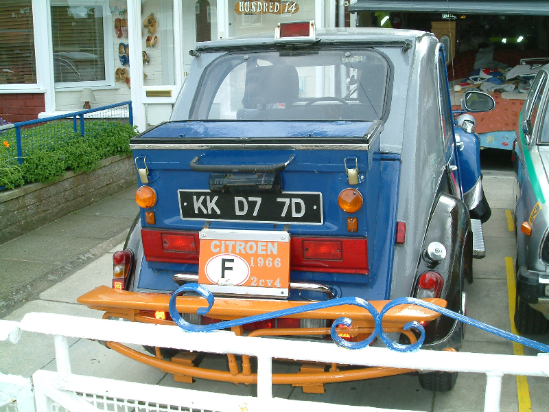

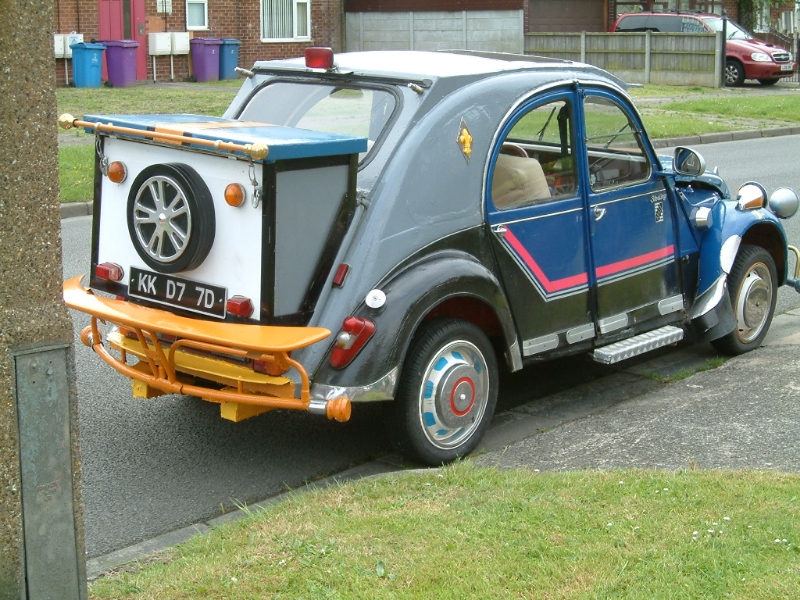

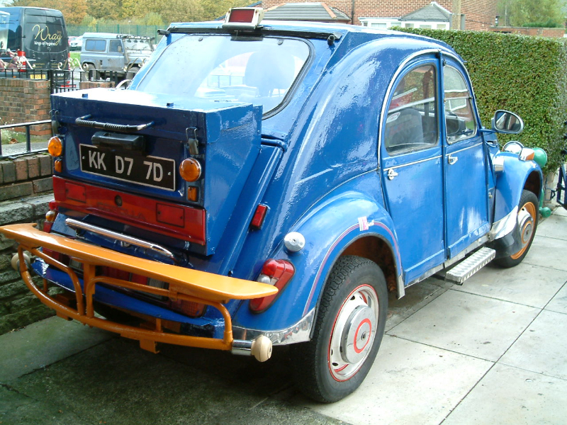

Old2cvman... stopping by'e with another Historic memory...... I built this Red Devil, in the early 1980s... from a scrapper I bought cheap.....another vehicle to my abundance fleet, of 2 C.V. variants that a used at weekend events, I ran this for approx five years.... before she sadly died. in a quick Cremation Ceremony.
I was driving home from work one evening, and the Petrol delivery pipe up to the Carburetor, slipped of its mounting and pumped fuel onto a red hot manifold, the underside of my Bonnet was lined with 2 inch thick noise eliminating Wadding, which caught fire instantly... in 6 seconds of braking and jumping out the Car to save my Life... she was gone.... before you ask..... Oh Yes I had a Commercial Heavy duty extinguisher under the passenger seat... it was a senario of Run for your Life.

The solution is call "serflex"old2cvman a écrit :the Petrol delivery pipe up to the Carburetor, slipped of its mounting .

The lesson is ?
Always buy an extinguisher ? Ask your passenger to watch after de fuel pipe ?
Not of all, today's lesson is : fuel pipe end must be strongly tight Serflex or Colson band.
Anyway, she was saved and you too

Ouch ! Poor car ! You save your life, it the most important ... (The AUDI in the back seems to have had the same story as yours

Why died ? Ready for re-building and for a new life !

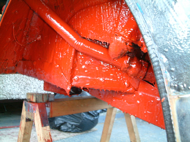

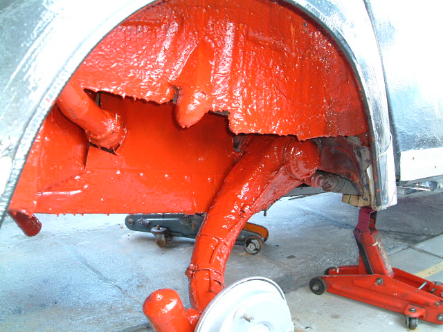

My vehicles are always modified, improvisation gives them the Kiss of Long Life... this is 52 years young...any one with loads of Money can purchase new panels and parts, but my approach is re manufacture your self every thing you need, this way experience teaches you knowledge and skills, I have just re strengthened all my rear under the Boot Chassis, with steel fit for a Battle Ship, and the Chassis Edged with Angle Iron.... its therapeutic experience, and stimulates my BRAIN and my ABILITIES to improve on things.
I dont build these to Win academy awards .. or compliments from 2 C.V. owners, I do this to sustain road worthy vehicles that will last a life time, with minimal break downs....

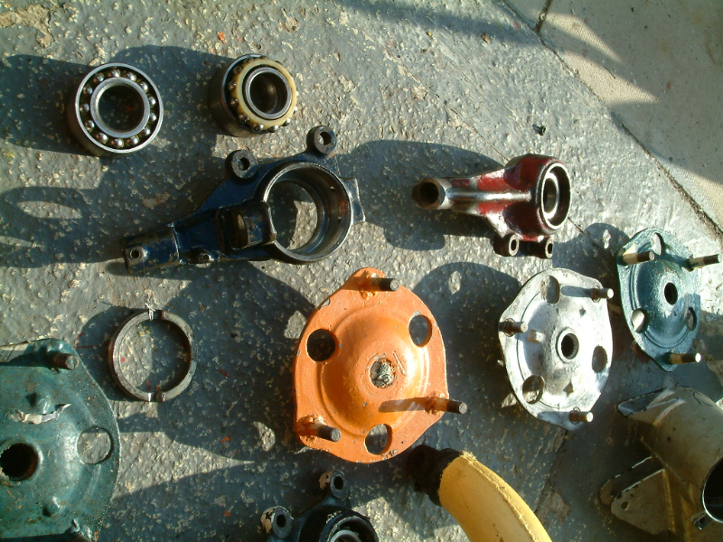

Hello all readers.... Old2cvman... stopping bye,its been some time since I contributed some dialogue to these pages... for those who remember my posts, I under went life saving surgery, on March 19th, after the beloved Dream Car of my life, dropped of the Jack, onto my Left Shoulder and neck area, which resulted in a Neck Dissection Parotidectomy...an Eleven hours event in Surgery.
At 86 years young... this is quite an ordeal.... but I over came this and bounced back very gradually.
At this time my Citroen was almost like me... a basket case, but I eventually got it back in shape, and sued my city council.. which I was awarded £ 400...for Road Pot holes under body damage.
She has been running fine, for several months now, as too have myself, with various occupational projects, mainly my front Garden modification, See just a couple of pictures attached.

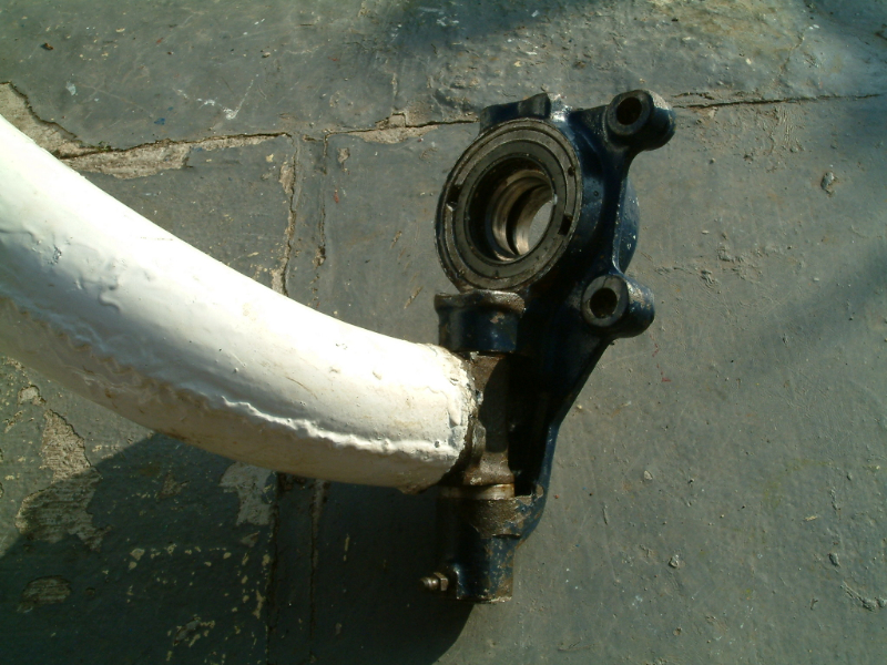

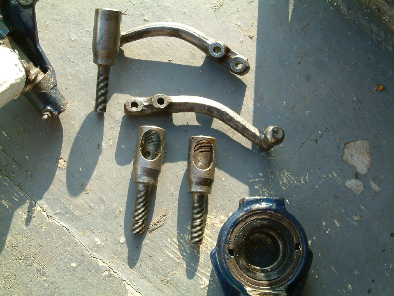

However a few weeks ago, whilst out driving, my Steering arm linkage to the Hub came adrift, left hand side, ( My vehicle is a Left Hand drive ) I had just made a right turn on a main junction, 7 a.m. Sunday morning, and was starting to accelerate , suddenly the left wheel turned complete left, and the car raised nose dived onto the Sidewalk.. and collapsed..
I was four miles from home, after inspection, I cut the near side safety belt, and fabricated it to bandage the axle arm, in a forward rolling position, and with numerous endeavors steering the vehicle I got the vehicle home.....which took best part of an hour to do.
I have since rebuilt from my spares stock pile,another N.Side axle beam, and Hub assembly, I modified the King Pin fitting thru the Axle beam, drilling the beam out with a 17 mm drill, and subsequently fitting King Pin bushes in the Beam as well as the Swivel Hub mounting. So there is still life in this old Jalopy which I have ran and modified since I acquired 53 years ago, it will still run from Liverpool England , down to Monte Carlo, France a distance of 1362 miles in Thirty one hours none stop .. I used to do it from time to time, to the Cannes Film Festival .
But thats another Story Folks.
