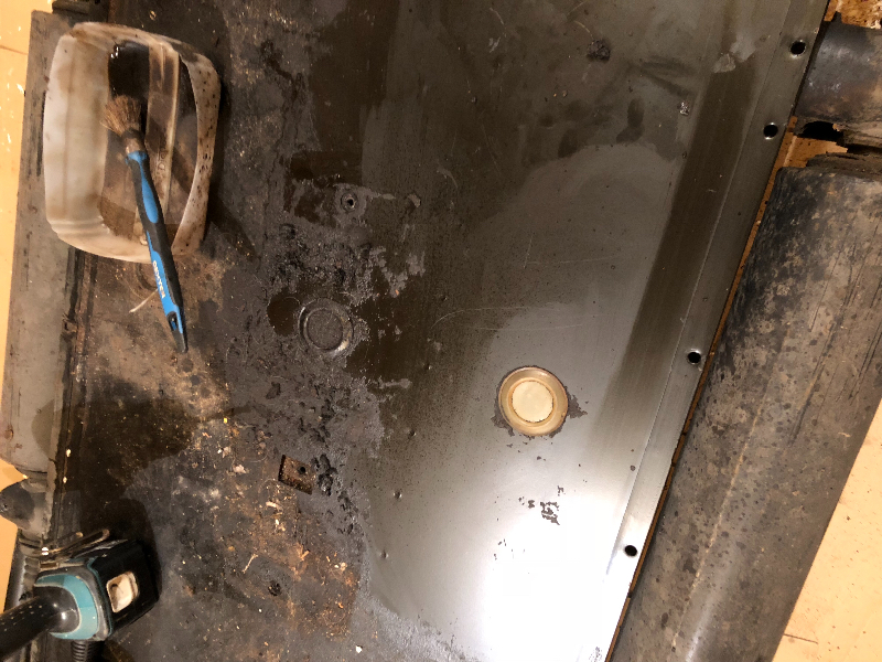

Aujourd’hui c’etait Nettoyage du châssis qui était complètement crasseux au nettoyant frein
C’est une horreur a nettoyer et je pense franchement que c’est de la cire pour corps creux qui a était Pulvérisé sur l’exterieur
old2cvman
Messages : 79
Âge : 93
Re: Restaurations de la 2CV6 de Vio68
Message par old2cvman »
Oh Yes, your picture displays a nice new looking flat metal construction bottom plate of your chassis, were you have cleaned it.... removing all this protective coating .... is INVITING RUST to FORM..
Years ago all new vehicles were under sealed, mostly at the purchasers cost.... when I was in the Trade a Car would cost £ 60.. this is 1953 period.. it was a rubberised spray on job.. but it did what its intended for protection... against the weather under side of your precious vehicle.
New vehicles of todays society, are recycled Corned Beef or Can Drinks metal smelted down into new materials the eventually turn up again as Cars.. supported by Plastic waste recycling materials , the same formula ....thats todays World .. in a quick analysis .
Get yourself a Couple of Gallon Tins of WAX OIL...the cost will be £ 10. and thicken it on every were underside..... if you Run over some body.... the Wax will help slip them out from under your 2.C.V. easier. and you wont see Rot forming after you follow my words of knowledge.
vio68
Messages : 40
Enregistré le : 01 août 2017, 05:56
Ma deuche : 2CV 6 Special
Date de naissance : 15 sept. 1986
Localisation : Alsace (68)
Message par vio68 »
Hey
actually remove it invites rust to this formed yes !!!
But this wax is only on the top and only on the middle of the frame and view that we will treat all the chassis with anti-rust paint better your all do
moreover this wax is not hard and sticky
thank you for the advice

Pièces mais à quoi sert cette pièces ?
Messages : 3325
:salut: C'est le régulateur , comme son nom l'indique il régule le courant envoyé de l'alternateur à la batterie.
Message par vio68 »
Ah ok !!! :cafe:
Malheureusement sur mon nouveau faisceau j’ai pas le même branchement
